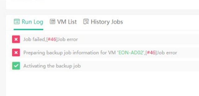

Victor Bramwell When backing up a Sangfor SCP6.10_R1 virtual machine, runlog reports error #46 [ERROR:46#Task failed]: update cbt info error [ERROR:46#Task failed]: Task<cace0432-fce1-4231-ab9c-927145329e67> update cbt status error, How to fix it?
Quentin Check if there is a snapshot under the virtual machine when backing up, which may cause the CBT function to fail.
Victor Bramwell Quentin I checked and it was indeed an issue with the snapshot. After deleting the snapshot under this virtual machine and restarting the backup, the problem has been resolved. Thanks.
