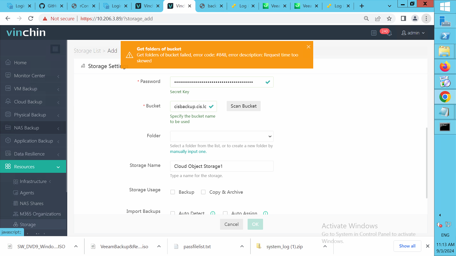

Hi, you can try syncing the time manually in System > Time Configuration.
After syncing, the bucket might still not be added immediately — just wait for a while or restart the system, then try again. That worked for me and solved the issue.
Hope it works on your side too.
