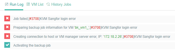

Marshall Beckett Ah, I’ve run into this issue too! Error #3708 is such a headache 😩. I finally figured out it was a small configuration problem after digging through the logs. Hope you can get it fixed soon!
Leo Marshall Beckett I finally found my password wrong. Then I Add Sangfor platform again and confirm password correct. Now everything is working well.
